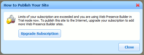

When the site is ready and the customers click Publish, they are prompted to upgrade their subscription.
If the upgrade is successfully completed, the site can be published to the upgraded hosting account.

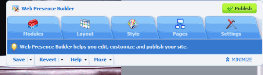

When the customers click the link, they are forwarded to Presence Builder where they create trial sites. The editor interface is identical to the one that appears in step 2.

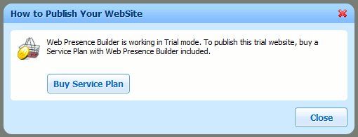

As soon as the site is ready, the customers click Publish, and Plesk requests them to buy a hosting plan.
The customers subscribe to a new plan and are free to publish the site.
