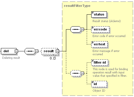

Response Packet Structure
The del node of the response packet is structured as follows:
image 66614
  • result, optional
    It wraps the result of the requested operation. It can be missing if some error occurs before the validation starts. Data type: resultFilterType (common.xsd).
  • status, required
    It returns the execution status of the operation. Data type: string. Allowed values: ok | error.
  • errcode, optional
    It is used to return an error code when the operation fails. Data type: unsignedInt.
  • errtext, optional
    Can be used to return an error message if the operation fails. Data type: string.
  • filter-id, optional
    It is always present and used to return the parameter by which the site was filtered by in the request packet. Data type: anySimple.
  • id, optional
    It is missing if the request packet fails before the validation on the server side. If present, this node identifies the deleted site. Data type: integer.
