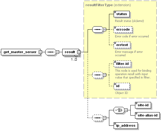

Response Packet Structure
The get_master_server node of the output XML packet is structured as follows:
- The result node is required. It wraps the response from the
server. Data type: resultFilterType (
common.xsd). - The status node is required. It specifies the execution status of the get_master_server operation. Data type: string. Allowed values: ok | error.
- The errcode node is optional. It is used to return the error code when the get_master_server operation fails. Data type: unsignedInt
- The errtext node is optional. It is used to return the error message if the get_master_server operation fails. Data type: string.
- The id node is optional. It is required if the operation get_master_server has succeeded. Returns the ID of the primary name server in Plesk database. Data type: integer.
- The filter-id node is optional. It holds the filtering rule parameter. For info on filters, refer to the Available Filters section. Data type: integer.
- The site-id node is required. Specifies the ID of the site, which zone will be served by the primary name server. Data type: integer.
- The site-alias-id node is required. Specifies the ID of the site alias, which zone will be served by the primary name server. Data type: integer.
- The ip_address node is required. Specifies the IP address of a primary name server. Data type: integer.
