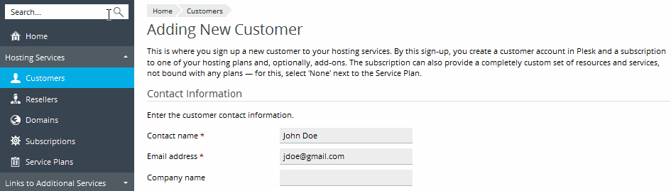

To create a new customer account without a subscription:
  1. Go to Customers, and click Add a Customer.
    Customer_create
  2. Specify the customer's contact and billing information, Customer Panel account's username and password.
  3. Clear the Create subscription for the customer checkbox.
  4. Click OK.

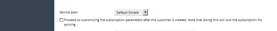

To subscribe a new customer to a service plan and, optionally, add-ons:
  2. Specify the customer contact/billing information, user name and password, and attributes of the domain linked with the subscription.
  3. Select a service plan with which the subscription should be associated.
  4. Select add-on plans if you wish to add any.
  5. Leave the Proceed to customizing the subscription checkbox cleared.
  6. Click OK.

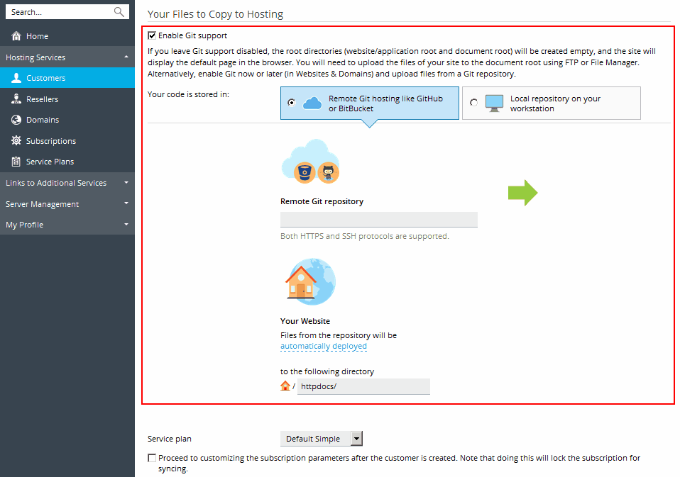

To enable Git support for transferring files to hosting:
  1. Go to Subscriptions, and click Add Subscription.
  2. Specify attributes of the domain provisioned with the subscription, service plan and add-ons.
  3. In the Your Files to Copy to Hosting section select Enable Git support.
    Plesk will create a Git repository for the subscription's domain. This repository will be used for transferring the files to a target public directory. You can select one of two types of Git repository depending on where your code is stored in:
    1. Remote git hosting like GitHub or BitBucket. In this case, you send the changes to this remote repository, and then Plesk pulls them from the remote repository and deploys to your web site. This scenario may be useful if you already work with some remote repository in GitHub (github.com) or BitBucket (bitbucket.org).
    2. Local repository on your workstation. In this case, you send the changes from your local repository to Plesk, and then Plesk deploys the changes to your web site.
  4. Specify the Git repository properties (for details, refer to Git support).
  5. Click OK.
Note: You can leave Git support disabled and add Git repository later, in the domains's settings.
