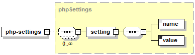

Custom PHP settings that are applied to all subscriptions with the add-on are defined by the php-settings node. This node is specified by complex type phpSettings (domain_addon_template.xsd) . This type is structured as follows:
image-webspace-phpSettings
  • The setting node is required. It specifies a certain PHP setting and its value.
    • The name node is required. It specifies a name of a certain PHP setting. Data type: string. You should use the same setting name that is used in the php.ini configuration file. Say, memory_limit, safe_mode, and so on.
    • The value node is required. It specifies a value of a certain PHP setting. Data type: string. You should use the same setting values that are used in the php.ini configuration file. Say, for memory_limit it can be 128M or on for the safe_mode parameter. If you want to set the default value to a PHP parameter, send the request with the blank value node.
