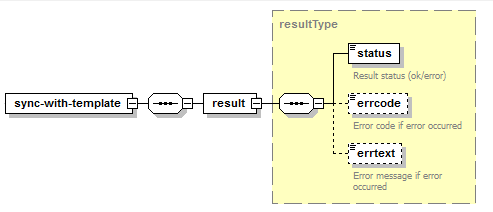

Response Packet Structure
The sync-with-template node of the output XML packet is structured as follows:
image-DNS-sync-with-template-response
  • The result node is required. It wraps the response retrieved from the server. Data type: resultType (common.xsd).
  • The status node is required. It specifies the execution status of the add_rec operation. Data type: string. Allowed values: ok | error.
  • The errcode node is optional. It is used to return the error code when the add_rec operation fails. Data type: unsignedInt.
  • The errtext node is optional. It is used to return the error message if the add_rec operation fails. Data type: string.
