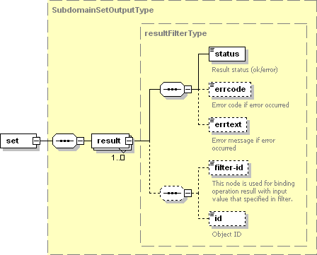

Response Packet Structure
The set node of the output XML packet is structured as follows:
image-SubdomainSetO
  • The result node is required. It wraps the response retrieved from the server. Data type: ResultFilterType (common.xsd).
  • The status node is required. It specifies the execution status of the get operation. Data type: result_status (common.xsd). Allowed values: ok|error.
  • The errcode node is required if the set operation fails. It returns the error code. Data type: unsignedInt.
  • The errtext node is required if the set operation fails. It returns the error message. Data type: string.
  • The filter-id node is required if the set operation succeeds. It returns the parameter by which the subdomain was filtered in the request packet. Data type: anySimple.
  • The id node is required if the set operation succeeds. It returns the ID of the subdomain which settings are retrieved in the response packet. Data type: id_type (common.xsd).
