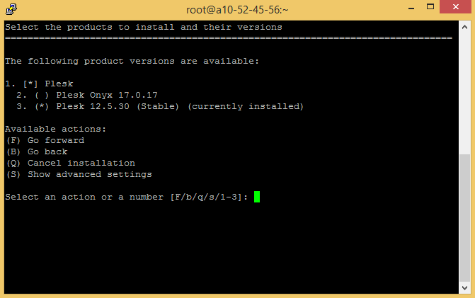

Read the text marked with "IMPORTANT", then type the character F and press the Enter key to proceed.

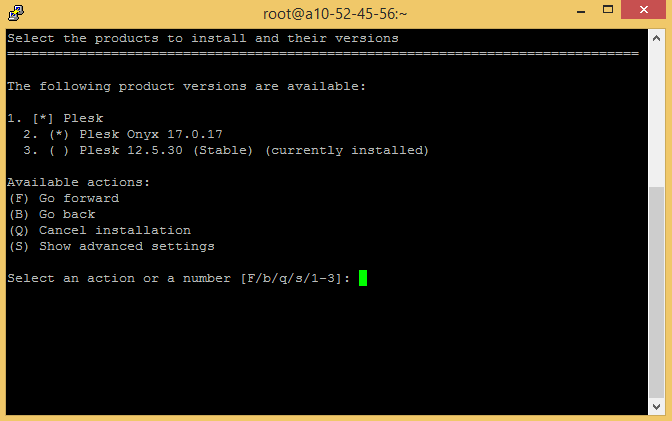

Next, you need to select to which version of Plesk you want to upgrade. Here you are about to upgrade to the latest Plesk release.
If you ran the installer with the --tier testing option, you will also be able to select the latest preview of the upcoming Plesk release.

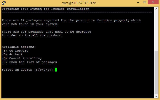

Type F and press Enter to continue. Plesk installer will download the installation files for the selected Plesk version and prompt you for confirmation.
Type F and press the Enter key to begin the upgrade.
