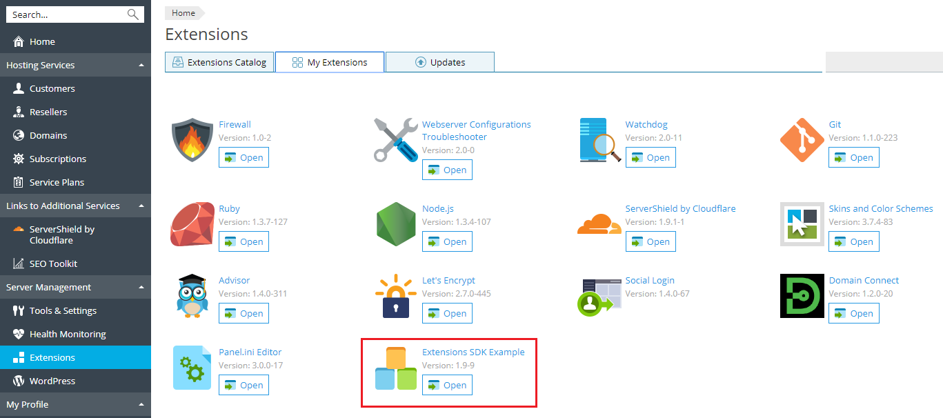

Step 2. The next step is to register the extension in Plesk. Run the following command:
plesk bin extension --register my_extension
As a result, the new extension will be displayed in the list of extensions on the Extensions page of the Plesk user interface:
