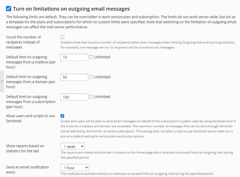

To protect against spam by limiting outgoing mail, follow the steps:
Turn on limitations on outgoing mail in the mail server settings at Tools & Settings > Mail Server Settings. See Configuring Server-Wide Mail Settings.
Remove all IP addresses and networks from the mail server’s white list (located in Plesk for Linux in Tools & Settings > Mail Server Settings > White List tab, in Plesk for Windows in Tools & Settings > Mail Server Settings > Relay options > Use no relay restrictions for the following networks). The limits on outgoing mail will not work for mail senders whose IP addresses are in the white list.
Note: Note: Starting with Plesk 12, the 127.0.0.0/8 network is no longer added to the whitelist by default. This is necessary for outbound spam protection to function correctly. Not having localhost whitelisted prevents PHP scripts from sending mail on Windows. Other scripting engines may be affected as well. Also, Mailman will not be able to send emails to external email addresses.
(Optional) Set the period of time for gathering statistics used for displaying reports. The same period is used for determining the outgoing mail status, which is displayed on the Plesk UI Home page. See Configuring Server-Wide Mail Settings.
(Optional) Set the period of time for notifications about outgoing mail. See Notifications About Attempts to Exceed Limits.
(Optional) Change the limits that are used by default on Plesk objects. See Custom Limits.

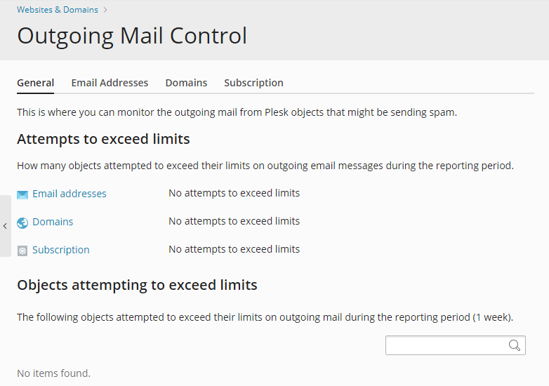

Analyze the statistics on attempts to exceed limits at Tools & Settings > Outgoing Mail Control. See Statistics and Reports.
Note: The Outgoing Mail Control link is displayed only if the limitations are turned on in the mail server settings.
