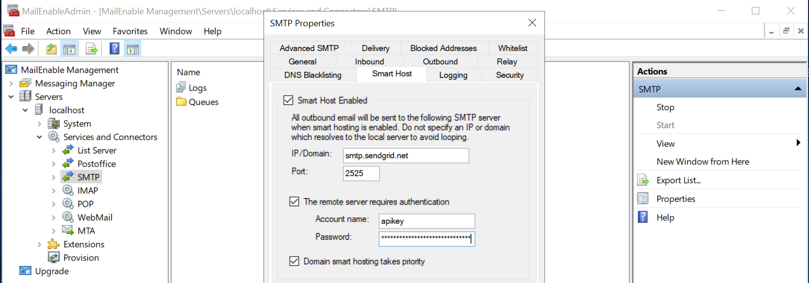

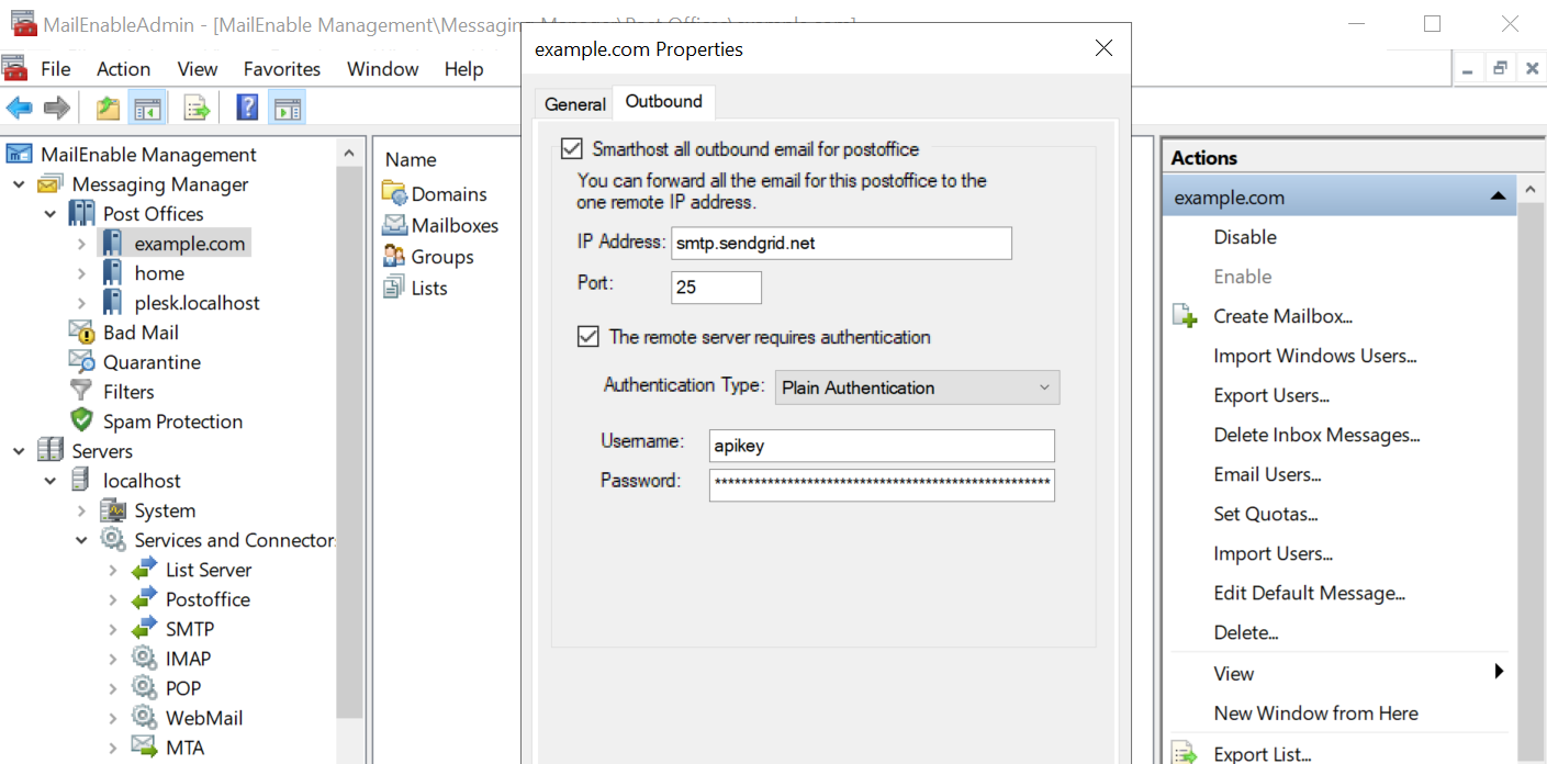

(Plesk for Windows) Smarthost Configuration with MailEnable
When you enable the smarthost feature, Plesk applies the MailEnable configuration shown on the screenshot below. We use the SendGrid SMTP relay service as an example.
The first screenshot shows the server-wide configuration, while the second one—the configuration for domains.
image smarthost mailenable
image smarthost mailenable domain
Note: Domain‑level smarthosts take priority over the server‑wide smarthost configured in Plesk.

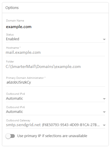

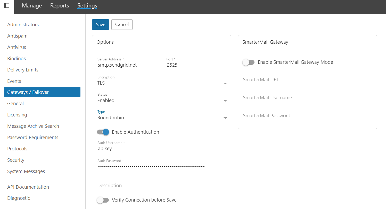

(Plesk for Windows) Smarthost Configuration with SmarterMail
When you enable the smarthost feature, Plesk applies the SmarterMail configuration shown on the screenshots below. We use the SendGrid SMTP relay service as an example.
image smarthost smartermail 1
image smarthost smartermail 2
