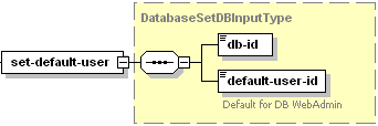

The set-default-user node is presented by type DatabaseSetDBInputType (database_input.xsd), and its graphical representation is as follows:
image 37560
  • The db-id node is required. Specifies the database that will be accessed by the default database user. Data type: integer.
  • The default-user-id node is optional. Specifying the default database user for managing a database. Data type: integer.

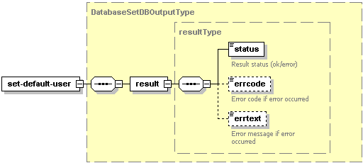

Response Packet Structure
The set-default-user node of the output XML packet is presented by type DatabaseSetDBOutputType (database_output.xsd) and structured as follows:
image 37562
  • The result node is required. It wraps the response retrieved from the server. Data type: resultType (common.xsd).
  • The status node is required. It specifies the execution status of the set-default-user operation. Data type: string. Allowed values: ok | error.
  • The errcode node is optional. Is returns the error code if the set-default-user operation fails. Data type: integer.
  • The errtext node is optional. It returns the error message if the set-default-user operation fails. Data type: string.
