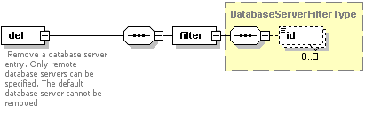

The del node has the following graphical representation:
- The filter node is required. Specifies the filtering rule. Data
type: DatabaseServerFilterType (
database_input.xsd
). - The id node is optional. It specifies ID of the database server to be detached. Data type: integer.

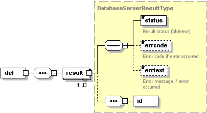

Response Packet Structure
The del node of the output XML packet is structured as follows:
- The result node is required. It wraps the response retrieved
from the server. Data type: DatabaseServerResultType
database_output.xsd
). - The status node is required. It specifies the execution status of the del operation. Data type: string. Allowed values: ok | error.
- The errcode node is optional. Is returns the error code if the del operation fails. Data type: integer
- The errtext node is optional. It returns the error message if the del operation fails. Data type: string.
- The id node is optional. It returns the ID of the database server. Data type: integer.
