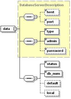

The data node is optional. Data type: databaseServerDescription ( plesk_db.xsd) If the get operation succeeded it returns the following data:- The host node is optional. Specifies the IP address or name of the database server. Data type: string.
- The port node is optional. It specifies the port of the database server. Data type: string.
- The type node is required. It returns the type of the database server. Data type: string.
- The admin node is required. It specifies the login name of administrator of the database server. Data type: integer.
- The password node is optional. It specifies the password of the administrator of the database server. Data type: integer.
- The status node is required. It specifies the status of connection to the database server. Data type: string. Allowed values: NO_ERROR | CONNECTION_FAILED | LOGIN_FAILED | PERMISSION_DENIED | OTHER_ERROR | CREDENTIALS_NOT_SET
- The db_num node is required. It specifies the number of databases managed by the database server. Data type: integer.
- The default node is optional. It specifies a default database server. Data type: none.
The local node is optional. It specifies a local database server. Data type: none.
