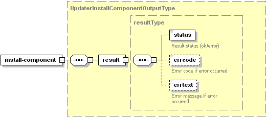

Response Packet Structure
The install-component node of the output XML packet is presented by type UpdaterInstallComponentOutputType (updater.xsd) and structured as follows:
image 40357
  • The result node is required. It wraps the response retrieved from the server. Data type: resultType (common.xsd).
  • The status node is required. It specifies the execution status of the operation. Data type: string. Allowed values: ok | error.
  • The errcode node is optional. Is returns the error code if the install-component operation fails. Data type: integer.
  • The errtext node is optional. It returns the error message if the install-component operation fails. Data type: string.
