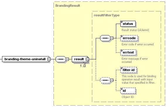

Response Packet Structure
The branding-theme-uninstall node of the output XML packet is structured as follows:
Note
The result node is required. It wraps the response retrieved from the server. Data type: resultFilterType (
common.xsd).The status node is required. It specifies the execution status of the operation. Data type: result_status. Allowed values: ok | error.
The errcode node is optional. Is returns the error code if the operation fails. Data type: unsignedI nt.
The errtext node is optional. It returns the error message if the operation fails. Data type: string.
The filter-id node is optional. Returns the parameter by which the custom theme was filtered by in the request packet. Data type: anySimple.
The id node is optional. Returns the identifier of the uninstalled custom theme. Data type: id_type (
common.xsd).
