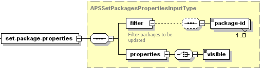

The set-package-properties node is structured as follows:
  • filter, required
    This node sets a filtering rule to match particular packages. Data type: none.
    If it is defined with an empty value, than all packages will be matched.
  • package-id, optional
    Specifies the ID of package on the server from which an application should be installed. Data type: id_type (common.xsd).
  • properties, required
    Aggregates the package properties. Data type: complex.
  • visible, required
    Defines whether to display this package to customers and resellers among other packages in Application Catalog. Data type: boolean.

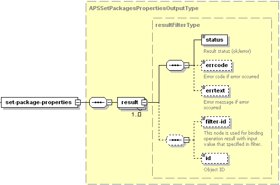

The set-package-properties node of the output XML packet is structured as follows:
  • result, required
    Wraps the response retrieved from the server. Data type: resultType (common.xsd).
  • status, required
    Specifies the execution status of the operation. Data type: string. Allowed values: ok | error.
  • errcode, required if the operation fails
    Returns the error code. Data type: integer.
  • errtext, required if the operation fails
    Returns the error message. Data type: string.
  • filter-id, required if the operation succeeds
    Returns the package ID by which the operation was filtered. Data type: any.
  • id, optional.
    Not returned.
