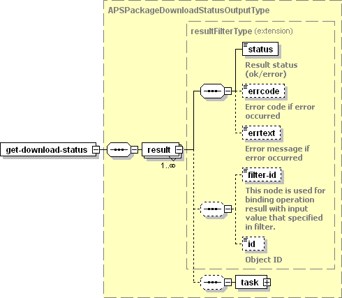

Response Packet Structure
The get-download-status node of the output XML packet is structured as follows:
  • result, required
    Wraps the response retrieved from the server. Data type: resultType (common.xsd).
  • status, required
    Specifies the execution status of the operation. Data type: string. Allowed values: ok | error.
  • errcode, required if the operation fails
    Returns the error code. Data type: integer.
  • errtext, required if the request contained non-empty filter
    Returns the error message. Data type: string.
  • filter-id, required if the operation succeeds
    Returns the ID by which the operation was filtered. Data type: any.
  • id, required if the operation succeeds
    Returns the ID of the download task whose status is retrieved. Data type: id_type (common.xsd)

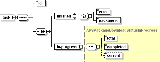

  • task, optional
    Holds a collection of data describing the download task status. Data type: none.
    Structured as follows:
  • id, required
    Returns the ID of the download task whose status is retrieved. Data type: id_type (common.xsd).
  • finished, optional
    Specifies that the download task is finished. Data type: none.
  • in-progress, optional
    Specifies that the download task is in progress, or is placed in the download queue in case several packages are specified for download at a time. Data type: APSPackageDownloadStatusInProgress (aps.xsd).
  • error, optional
    Specifies that the download was finished with error. Contains error description. Data type: none.
  • package-id, required if the package download completed successfully
    Specifies that the download was finished successfully and returns the ID assigned to the package on your server. Data type: id_type (common.xsd).
  • total, required
    Specifies the total application size in bytes. Data type: integer.
  • completed, required
    Specifies the size of the downloaded part, also in bytes. Data type: integer.
  • current, optional
    Specifies that the download task is currently in progress, opposed to the tasks awaiting at the download queue. Data type: string.
