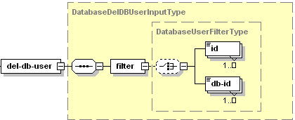

The del-db-user node is presented by type DatabaseDelDBUserInputType (database_input.xsd), and its graphical representation is as follows:
image 37567
Note
  • The filter node is required. Specifies the filtering rule. For more information, refer to the Available Filters section. Data type: DatabaseUserFilterType.
  • The id node is optional. It specifies the ID of the user you want to delete. Data type: integer.
  • The db-id node is optional. It specifies the ID of the database where a new user will be created. Data type: integer.
Remarks
You can delete multiple users from the database using a single packet. Add as many del-db-user operations as the number of different users you want to delete from the database.

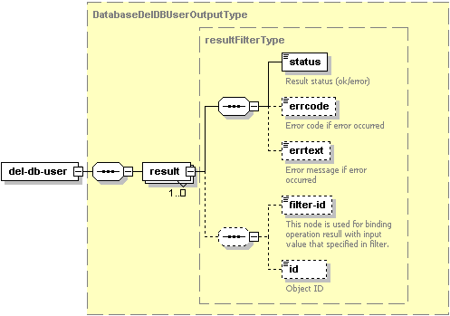

The del-db-user node of the output XML packet is presented by type DatabaseDelDBUserOutputType (database_output.xsd) and structured as follows:
image 37568
Note
  • The result node is required. It wraps the response retrieved from the server. Data type: resultFilterType (common.xsd).
  • The status node is required. It specifies the execution status of the del-db-user operation. Data type: string. Allowed values: ok | error.
  • The errcode node is optional. It returns the error code if the del-db–user operation fails. Data type: integer.
  • The errtext node is optional. It returns the error message if the del-db–user operation fails. Data type: string.
  • The filter-id node is optional. It returns the filtering rule parameter. For more information, refer to the Available Filters section.
  • The id node is required. If the del-db-user operation succeeds, it specifies the database user ID. Data type: integer.
