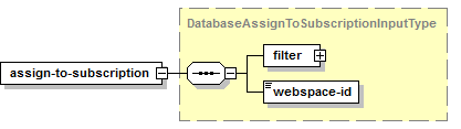

The assign-to-subscription node is presented by type
DatabaseAssignToSubscriptionInputType (database_input.xsd), and
its graphical representation is as follows:
- The filter node is required. It specifies the filtering rule. For information on filters, refer to the Available Filters section. Data type: DatabaseFilterType.
- The webspce-id node is required. It specifies the subscription to which the database will be moved. Data type: id_type.

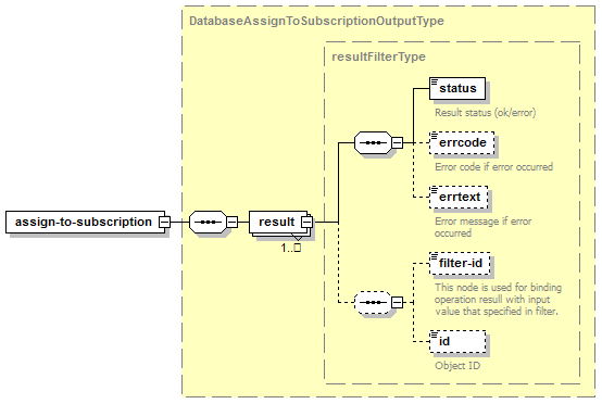

Response Packet Structure
The assign-to-subscription node of the output XML packet is
presented by type DatabaseSetDBOutputType (database_output.xsd)
and structured as follows:
- The result node is required. It wraps the response retrieved
from the server. Data type: resultType (
common.xsd). - The status node is required. It specifies the execution status of the set-default-user operation. Data type: string. Allowed values: ok | error.
- The errcode node is optional. Is returns the error code if the set-default-user operation fails. Data type: integer.
- The errtext node is optional. It returns the error message if the set-default-user operation fails. Data type: string.
- The filter-id or id node is optional. It returns the parameter of a filtering rule. Learn more in Available Filters.
