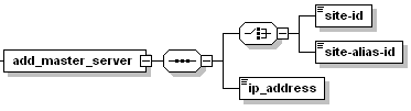

The graphical representation of the add_master_server node is as follows:
image 35002
Note
  • The site-id node is required. Specifies the ID of the site, which zone will be served by the primary name server. Data type: integer.
  • The site-alias-id node is required. Specifies the ID of the site alias, which zone will be served by the primary name server. Data type: integer.
  • The ip_address node is required. Specifies the IP address of a primary name server. Data type: integer.
You can add multiple primary name servers in a single packet. Add as many add_master_server operations as the number of different servers you want to add.

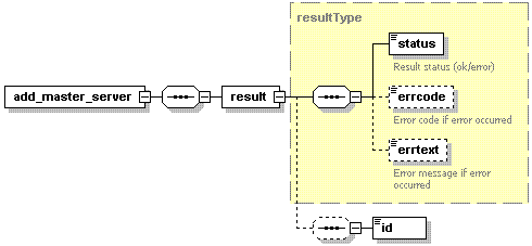

The add_master_server node of the output XML packet is structured as follows:
image 35006
Note
  • The result node is required. It wraps the response from the server. Data type: resultType (common.xsd).
  • The status node is required. It specifies the execution status of the add_master_server operation. Data type: string. Allowed values: ok | error.
  • The errcode node is optional. It is used to return the error code when the add_master_server operation fails. Data type: unsignedInt.
  • The errtext node is optional. It is used to return the error message if the add_master_server operation fails. Data type: string.
  • The id node is optional. It is required if the operation add_master_server has succeeded. Returns the ID of the primary name server in Plesk database. Data type: integer.
