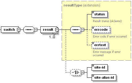

Response Packet Structure
The switch node of the output XML packet is structured as follows:
image 34997
  • The result node is required. It wraps the response from the server. Data type: resultType (common.xsd).
  • The status node is required. It specifies the execution status of the get operation. Data type: string. Allowed values: ok | error.
  • The errcode node is optional. It is used to return the error code when the switch operation fails. Data type: unsignedInt
  • The errtext node is optional. It is used to return the error message if the switch operation fails. Data type: string.
  • The site-id node is optional. It is required if the site ID was set as a filtering rule in the request packet. Data type: integer.
  • The site-alias-id node is optional. It is required if the site alias ID was set as a filtering rule in the request packet. Data type: integer.
