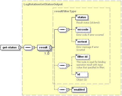

Response Packet Structure
The get-status node of the output XML packet is presented by type
LogRotationGetStatusOutput (logrotation.xsd) and structured as
follows:
- The result node is required. It wraps the response retrieved
from the server. Data type: resultFilterType (
common.xsd). - The status node is required. It specifies the execution status of the get-status operation. Data type: string. Allowed values: ok | error.
 - The errcode node is optional. It returns the error code if the get-status operation fails. Data type: unsignedInt.
 - The errtext node is optional. It returns the error message if the get-status operation fails. Data type: string.
 - The filter-id node is required. It returns a filtering rule parameter. For more information, refer to the Available Filters section. Data type: anySimple.
 - The id node is optional. If the get-status operation succeeds it holds the ID of the site matched by the filtering rule. Data type: integer.
 - The enabled node is optional. If the get-status operation succeeds, it holds status of the service on the site. Data type: integer.
