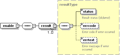

Response Packet Structure
The enable node of the response packet is structured as follows:
The result node is optional. It wraps the result of the requested
enable operation. Data type: resultType (common.xsd).
- The status node is required. It returns the execution status of the enable operation. Data type: string. Allowed values: ok | error.
- The errcode node is optional. It is used to return an error code if the enable operation fails. Data type: unsignedInt.
- The errtext node is optional. Can be used to return an error message if the enable operation fails. Data type: string.
