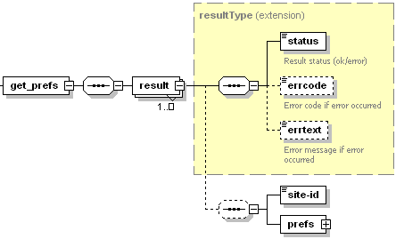

Response Packet Structure
The get_prefs node of the response packet is structured as follows:
image 34548
Note
  • The result node is optional. It wraps the result of the requested get_prefs operation. It can be missing if some error occurs before the validation starts. Data type: resultType (common.xsd).
  • The status node is required. Returns the execution status of the get_prefs operation. Data type: string. Allowed values: ok | error.
  • The errcode node is optional. Returns an error code when the get_prefs operation fails. Data type: unsignedInt.
  • The errtext node is optional. Returns an error message if the get_prefs operation fails. Data type: string.
  • The site-id node is optional. Returns the identifier of the site which mail service settings are retrieved. Data type: integer.
  • The prefs node is optional. Returns a collection of mail service preferences set for the specified site. Data type: MailPreferences (plesk_mail.xsd). The structure of the node is described in the Mail Service Settings section.
