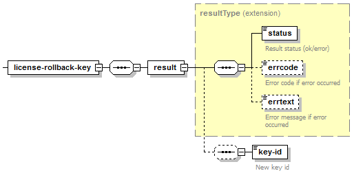

Response Packet Structure
The license-rollback-key node of the output XML packet is of complex
type (server_output.xsd) which has the following presentation:
result, required.
It wraps the result of the operation. Data type: resultType
common.xsd). - status, required. It returns the execution status of the operation. Data type: string. Allowed values: ok | error.
- errcode, required if the operation fails. It returns error code. Data type: unsignedInt.
- errtext, required if the operation fails. It returns error message. Data type: string.
- key-id, optional. It returns the ID number of the rolled back license key if the operation succeeded. Data type: string.
