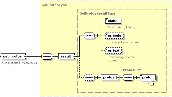

The get_protos node is presented by the GetProtosType
(server_input.xsd).
Note: The get_protos operation is available for the Plesk administrator, customers, and resellers.
Response packet
The get_protos node of the response packet received from server is
presented by the complex type GetProtosType (server_output.xsd)
and is structured as follows:
- The result node is required. It wraps the response retrieved
from the server. Data type: GetProtosResultType
server_output.xsd). - The status node is required. It specifies the execution status of the get_protos operation. Data type: string. Allowed values: ok | error.
- The errcode node is optional. It is used to return the error code when the get_protos operation fails. Data type: unsignedInt.
- The errtext node is optional. It is used to return the error message if the get_protos operation fails. Data type: string.
- The protos node is required if the get_protos operation has
succeeded. It hold the list of XML API protocol versions supported on
the server. Data Type: ProtosList (
server_output.xsd). - The proto node is required if the get_protos operation has succeeded. It specifies a supported version of XML API protocol. Data type: string.
