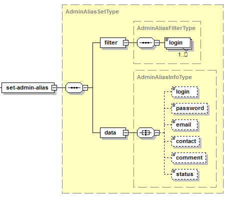

The set-admin-alias node is presented by the complex type
AdminAliasSetType (plesk_server.xsd) and structured as follows:
- The filter node is required. It specifies the filtering rule.
Data type: AdminAliasFilterType (
plesk_server.xsd). This node contains the following nodes:- The login node is required. It specifies the login of an additional administrator. Data type: string. This node can be used several times for editing multiple accounts.
- The data node is required. It contains a collection of settings
that will be set for the filtered user accounts. Data type:
AdminAliasInfoType (
plesk_server.xsd). This node contains the following nodes:- The login node is optional. It specifies the login of the additional administrator. Data type: string.
- The password node is optional. It specifies the password of the additional administrator. Data type: string.
- The email node is optional. It specifies the email of the additional administrator. Data type: emailType.
- The contact node is optional. It specifies the contact name of the additional administrator. Data type: string.
- The comment node is optional. It specifies some comment. Data type: string.
- The status node is optional. It the status of an additional administrator account (true means that account is active, false means that the account is inactive). Data type: boolean. The default value is true.

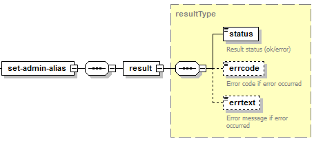

Response Packet Structure
The set-admin-alias node of the response packet is structured as follows:
- The result node is required. It wraps the result of the
set-admin-alias operation. Data type: resultType
common.xsd). This node contains the following nodes:- The status node is required. It returns the execution status of the operation. Data type: result_status. Allowed values: ok | error.
- The errcode node is required if the operation fails. Returns error code. Data type: unsignedInt.
- The errtext node is is required if the operation fails. Returns error message. Data type: string.
