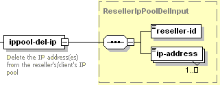

The ippool-del-ip node is specified by ResellerIpPoolDelInput
complex type (reseller.xsd). Its graphical representation is as
follows:
- The reseller-id node is required. It specifies the ID of a reseller account from whose IP pool an IP address is to be removed. Data type: integer.
- The ip-address node is required. It specifies an IP address
which is to be removed from a reseller’s IP pool. Data type:
ip_address (
common.xsd).

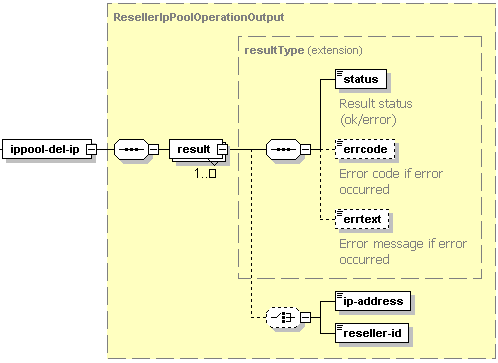

Response Packet Structure
The ippool-del-ip node of the response packet is structured as
follows (data type ResellerIpPoolOperationOutput (reseller.xsd)):
- The result node is required. It wraps the response retrieved
from the server. Data type: resultFilterType (
common.xsd).- The status node is required. It specifies the execution
status of the ippool-del-ip operation. Data type:
result_status (
common.xsd). Allowed values:ok|error. - The errcode node is required if the ippool-del-ip operation fails. It returns the error code. Data type: unsignedInt.
- The errtext node is required if the ippool-del-ip operation fails. It returns the error message. Data type: string.
- The ip-address node is required if the operation succeeds.
It returns the IP address added to the reseller’s IP pool. Data
type: ip_address (
common.xsd). - The reseller-id node is optional. It is not returned for this operation.
result_status (
