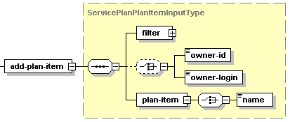

The add-plan-item node is presented by type
ServicePlanPlanItemInputType (domain_template.xsd). Its graphical
representation is as follows:
- The filter node is required. It serves to specify the criteria
by which the necessary service plans will be selected from the
database. Data type: DomainTemplateFilterType
domain_template.xsd). See the Available Filters section for details on this node. - The owner-id node is optional. It specifies the ID of the service plan owner. Data type: integer.
- The owner-login node is optional. It specifies the login name of the service plan owner. Data type: string.
- The plan-item node is required. It specifies what type of information about the additional service is requested.
- The name node is required. It specifies the name of the additional service that will be added to the service plan. Data type: string.

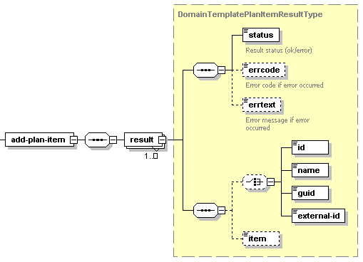

Response Packet Structure
The add-plan-item node of the output XML packet is of complex type
(domain_template.xsd) which has the following presentation:
- The result node is required. It wraps the response got from the
server. Data type: DomainTemplatePlanItemResultType
domain_template.xsd). - The status node is required. Specifies the execution status of the operation. Data type: string. Allowed values: ok | error.
- The errcode node is optional. Returns the error code when the operation fails. Data type: unsignedInt.
- The errtext node is optional. Returns the error message if the operation fails. Data type: string.
- The id node is optional. Returns the identifier of the additional service in Plesk database. Data type: integer.
- The name node is optional. Returns the name of the additional service added to the service plan. Data type: string.
- The guid node is optional. Returns the GUID of the additional service added to the service plan. Data type: string.
- The external-id node is optional. Returns the ID of the additional service which could be set by any external third-party integrator. Data type: string.
- The item node is optional. Returns the the additional service added to the service plan. Data type: integer.
