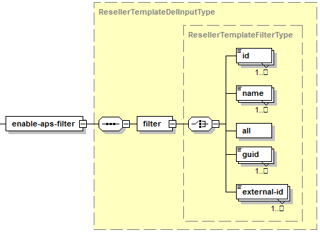

The enable-aps-filter node is presented by type ServicePlanApsFilterInputType (domain_template.xsd). Its graphical representation is as follows:
image 69091
  • The filter node is required. It serves to specify the criteria by which the necessary service plans will be selected from the database. Data type: DomainTemplateFilterType (domain_template.xsd). See the Available Filters section for details on this node.
  • The owner-id node is optional. It specifies the ID of the service plan owner. Data type: integer.
  • The owner-login node is optional. It specifies the login name of the service plan owner. Data type: string.

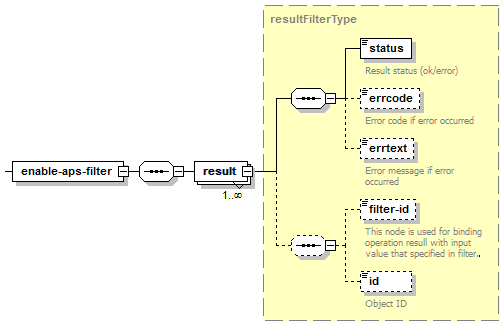

The enable-aps-filter node of the output XML packet is of complex type (domain_template.xsd) which has the following presentation:
image 69093
  • The result node is required. It wraps the response got from the server. Data type: resultFilterType (common.xsd).
  • The status node is required. Specifies the execution status of the operation. Data type: string. Allowed values: ok | error.
  • The errcode node is optional. Returns the error code when the operation fails. Data type: unsignedInt.
  • The errtext node is optional. Returns the error message if the operation fails. Data type: string.
  • The filter-id node is optional. Returns the parameter by which the service plan was filtered by in the request packet. Data type: anySimple.
  • The id node is optional. Returns the identifier of the service plan specified in the request. Data type: id_type (common.xsd).
