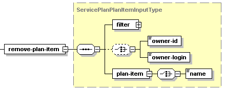

The remove-plan-item node is presented by type ServicePlanPlanItemInputType (domain_template.xsd). Its graphical representation is as follows:
  • The filter node is required. It serves to specify the criteria by which the necessary service plans will be selected from the database. Data type: DomainTemplateFilterType (domain_template.xsd). See the Available Filters section for details on this node.
  • The owner-id node is optional. It specifies the ID of the service plan owner. Data type: integer.
  • The owner-login node is optional. It specifies the login name of the service plan owner. Data type: string.
  • The plan-item node is required. It specifies what type of information about the additional service is requested.
  • The name node is required. It specifies the name of the additional service that will be removed from the service plan. Data type: string.

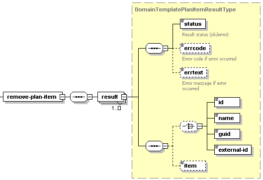

The remove-plan-item node of the output XML packet is of complex type (domain_template.xsd) which has the following presentation:
  • The result node is required. It wraps the response got from the server. Data type: DomainTemplatePlanItemResultType (domain_template.xsd).
  • The status node is required. Specifies the execution status of the operation. Data type: string. Allowed values: ok | error.
  • The errcode node is optional. Returns the error code when the operation fails. Data type: unsignedInt.
  • The errtext node is optional. Returns the error message if the operation fails. Data type: string.
  • The id node is optional. Returns the identifier of the additional service in Plesk database. Data type: integer.
  • The name node is optional. Returns the name of the additional service added to the service plan. Data type: string.
  • The guid node is optional. Returns the GUID of the additional service added to the service plan. Data type: string.
  • The external-id node is optional. Returns the ID of the additional service which could be set by any external third-party integrator. Data type: string.
  • The item node is optional. Returns the the additional service removed from the service plan. Data type: integer.
