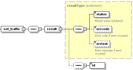

Response Packet Structure
The set_traffic node of the response packet is structured as follows:
result, optional
It wraps the result of the requested operation. It can be missing if some error occurs before the validation starts. Data type: resultType (
common.xsd). -
status, required
It returns the execution status of the operation. Data type: string. Allowed values: ok | error.
errcode, optional
Is used to return an error code when the operation fails. Data type: unsignedInt.
errtext, optional
Can be used to return an error message if the operation fails. Data type: string.
id, optional
Returns the identifier of the site whose traffic is set. It is missing if the request packet fails before the validation on the server side. Data type: integer.
