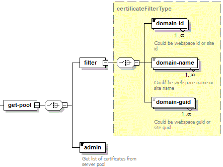

The get-pool node does not have a separate data type, it is nested
in type CertificateActionRequest (certificate_input.xsd). The node
has the following graphical representation:
- The filter node is optional. It is required if you retrieve a list of certificates for a particular domains.
- The admin node is optional. It is required if you retrieve a list of Administrator’s certificates.

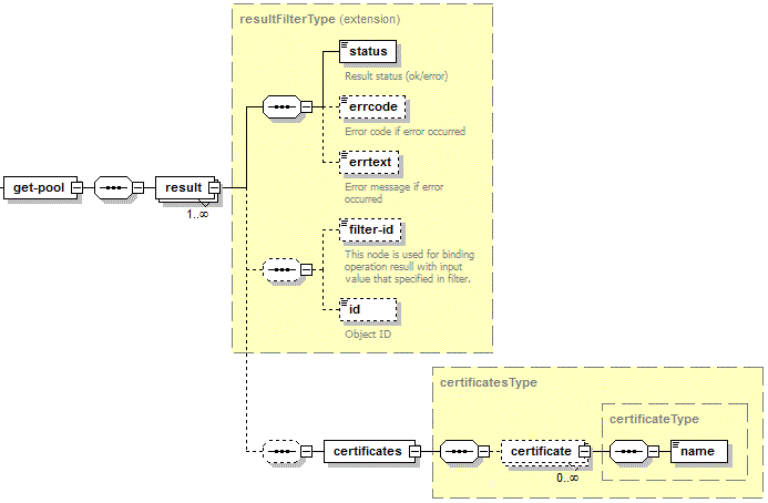

Response Packet Structure
The get-pool node of the output XML packet is structured as follows:
- The result node is required. It wraps the response retrieved
from the server. Data type: ResultFilterType (common.xsd).- The status node is required. It specifies the execution
status of the get-pool operation. Data type: result_status
(common.xsd). Allowed values:ok|error.
- The errcode node is required if the get-pool operation fails. It returns the error code. Data type: unsignedInt.
- The errtext node is required if the get-pool operation fails. It returns the error message. Data type: string.
- The filter-id node is optional. Data type: anySimple.
- The id node is optional. Data type: id_type
(common.xsd).
- The certificates node is required if the get-pool operation succeeds. It specifies the names of appropriate certificates.
