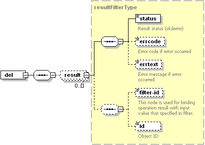

Response Packet Structure
The del node of the response packet is structured as follows:
- The result node is optional. It wraps the result of the
requested del operation. It can be missing if some error occurs
before the validation starts. Data type: resultFilterType
common.xsd). - The status node is required. It returns the execution status of the del operation. Data type: string. Allowed values: ok | error.
- The errcode node is optional. It is used to return an error code when the del operation fails. Data type: unsignedInt.
- The errtext node is optional. Can be used to return an error message if the del operation fails. Data type: string.
- The filter-id node is optional. It is always present and used to return the parameter by which the subscription was filtered by in the request packet. Data type: anySimple.
- The id node is optional. It is missing if the request packet fails before the validation on the server side. If present, this node identifies the deleted subscription. Data type: integer.
