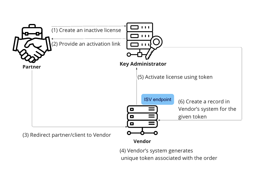

Integrating a software as a service solution with PAYG
Here is the typical workflow for the creation and the installation of a third-party license for a software as a service solution using the PAYG licensing model in Plesk:
A step-by-step description of the above diagram:
- A partner submits a request to Key Administrator for the creation of an inactive license.
- Key Administrator provides an activation link to the partner.
- The partner is redirected to the vendor’s system.
- The vendor’s system generates a unique vendor token associated with the order.
- The vendor activates the license in Key Administrator using the unique vendor token.
- Key administrator submits a request to the vendor’s system for the creation of a record for the provided unique vendor token.

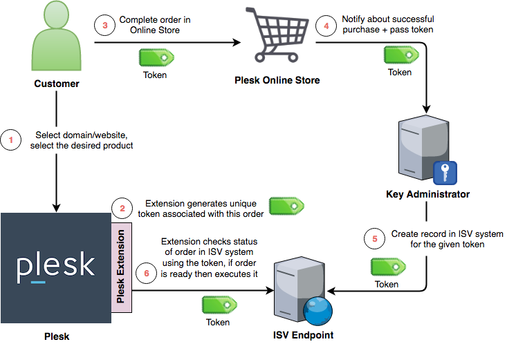

Individual Offers Licensing Model
Here is the typical workflow for the creation and delivery of a third-party license for an extension using the individual offers licensing model in Plesk:
- A customer (Plesk administrator or a Plesk end user) logs in to Plesk. The customer selects a domain or a website and chooses the desired product among the products offered by the extension.
- The extension generates an unique token that will be associated with the order and will be used through the entire workflow.
- The customer is forwarded to Plesk Online Store to complete his or her order. The token is passed as one of the query string parameters.
- The Online Store processes the payment, notifies KA about the purchase, and passes the token to KA.
- KA calls the ISV endpoint with a License Creation/Renewal/Upgrade
Request (the PURCHASE action) passing the token
inside the
ACTIVATION_DATAparameter. - The extension checks the status of the order on the ISV side using the token. When the order is ready for fulfillment, the extension executes it (e.g. delivers the product to the selected domain/website).
- The protocol used to check the status of the order is not specified and can vary from extension to extension.
