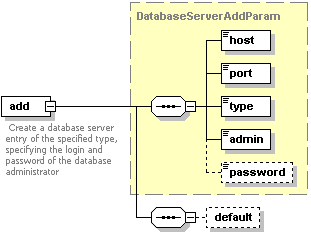

The add node is presented by type DatabaseServerAddParam (plesk_db.xsd), and its graphical representation is as follows:
  • The host node is required. It specifies the IP address or name of the database server you want to add. Data type: string.
  • The port node is required. It specifies the port of the database server. Data type: string.
  • The type node is required. It specifies the database server type. Data type: string. Allowed values: mysql | postgresql | mssql.
  • The admin node is required. It specifies the login name of administrator of the database server. Data type: integer.
  • The password node is optional. It specifies the password of administrator of the database server. Data type: integer.
  • The default node is optional. It specifies if the database server manages the databases of a certain type (defined by type). Data type: none.
