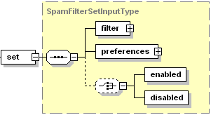

The set node is presented by the SpamFilterGetInputType type (spamfilter.xsd), and its graphical representation is as follows:
image 36844
  • The filter node is required. It specifies the filtering rule. Data type: SpamassassinFilterType (spamfilter.xsd).
  • The preferences node is required. It specifies preferences of Spam Filtering service for a specified user. For information on preferences, refer to the Spam Filtering Preferences section. Data type: SpamassassinPreferencesType (spamfilter.xsd).
    Note: If you want to enable or disable Spam Filtering service without changing preferences, leave the preferences node blank (<preferences/>).
  • The enabled node is optional. Specify this node to enable Spam Filtering service for a specified SpamAssassin user. For more information, refer to the Managing Spam Filtering section. Data type: none.
  • The disabled node is optional. Specify this node to disable Spam Filtering service for a specified SpamAssassin user. For more information, refer to the Managing Spam Filtering section. Data type: none.
