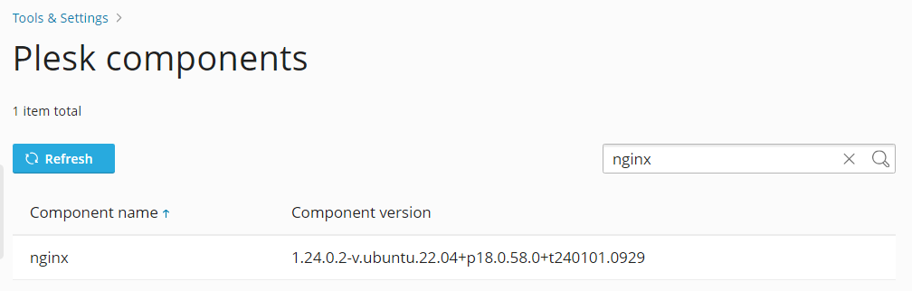

You can view the version of the installed nginx server in Tools & Settings > Server Components (under ”Server Management”).

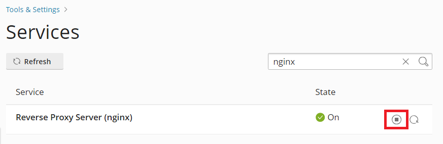

Turning off nginx
To return to the configuration with a single Apache web server, stop the Reverse Proxy Server (nginx) service in Tools & Settings > Services Management (under ”Server Management”).
image stop nginx
To make nginx the frontend web server again, start the Reverse Proxy Server (nginx) service.
Muista
The start and stop operations for the Reverse Proxy Server (nginx) service do not only start and stop nginx, they actually switch the web server configuration (nginx and Apache combination or just Apache as a frontend web server). The restart operation works in the same way as for all other services: the nginx service is restarted.
