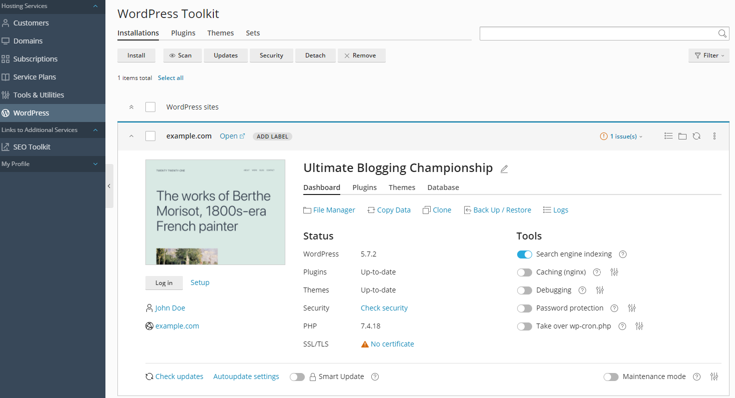

Go to WordPress to see all your WordPress installations.
WordPress Toolkit groups information about each installation in blocks we call cards.
image 79474
A card shows a screenshot of your website and features a number of controls that give you easy access to frequently used tools. The screenshot changes in real time to reflect the changes you make to your website. For example, if you turn on maintenance mode or change the WordPress theme, the screenshot of the website will change immediately.
注釈: WordPress で直接加えた変更は、24 時間ごとに WordPress Toolkit と同期されます。手動で同期するには、image 79475 ボタンをクリックしてください。
ウェブサイトのスクリーンショット上にカーソルを動かすと、[サイトを開く]ボタンが表示されます。このボタンをクリックすると、新しいブラウザタブでウェブサイトが開きます。
Here you can also do the following:
  • Change your website name. To do so, click the image icon pencil icon, give your website a name, and then click image icon tick.
    image change website name
  • Log in to WordPress as an administrator. To do so, click Log in below the website screenshot.
  • Change general WordPress settings. To do so, click “Setup” next to Log in.
  • Go to the domain's screen in Websites & Domains. To do so, click the domain name below the website screenshot.
    image website status
Status
WordPress websites are frequently targeted by hackers. Outdated WordPress core, plugins, and themes also pose a security risk.
In the “Status” section, you can do the following:
image 79455
The controls in the “Tools” section give you easy access to the following settings and tools:
Above the "Status" and "Tools" sections, you find the following WordPress Toolkit features:
image 79456
At the bottom of the website card, you can do the following:
On the remaining three tabs you can manage the installation’s plugins, themes, and change the database username and password.

On the installation's card next to "Security", you can see the following security messages:
  • "Fix security" means that not all critical security measures were applied.
    We strongly recommend that you apply them all.
  • "Check security" means that all critical security measures were applied,
    while some recommended measures were not.
  • "View settings" means that all security measures (critical and recommended) were applied.
image 79492

    image check security
  2. WordPress Toolkit にセキュリティ措置のリストが表示されるまで待ちます。
  3. 元に戻すセキュリティ措置を選択して[Revert(戻す)]をクリックします。
