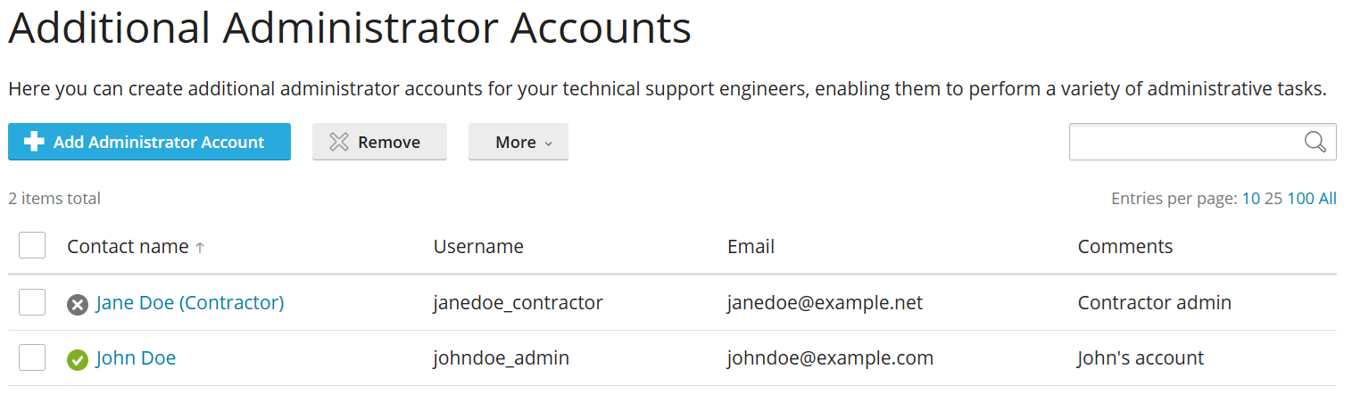

image additional admin accounts
An additional administrator account has its own login and password. It can be either restricted or unrestricted, which determines the following:
  • The level of access to the server the additional administrator account has.
  • The scope of tasks the person using one can do in Plesk.
小心
An unrestricted additional administrator account effectively has the same level of privileges and access to the server as the default administrator account. Do not give access to an unrestricted additional administrator account to anyone you would not trust with the default administrator account.
The actions of all additional administrator accounts are written to the Action Log. However, unrestricted additional administrator accounts are able to make changes to the log. Thus, only the actions of restricted additional administrator accounts can be reliably tracked this way.

  2. Go to Tools & Settings > Additional Administrator Accounts (under “Security”).
  3. Click Add Administrator Account.
