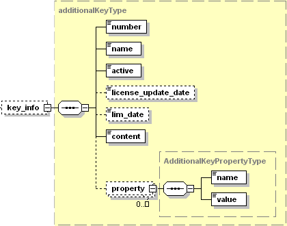

The key_info node is optional. It is required if the response successfully retrieves data of the specified key. Data type: additionalKeyType (
server_output.xsd). The node structure is the following:- The number node is required. It returns the key number. Data type: string.
- The name node is required. It returns the full key name in format “[key_number]/[key_name]”. Data type: string.
- The active node is required. It specifies if the key is installed and working, or if it is expired. Data type: boolean.
- The license_update_date node is required if key expiration date is defined. It returns the date (in format YYYYMMDD) when a grace period starts, during which the key must be updated. Data type: integer.
- The lim_date node is optional. It returns the date (in format YYYYMMDD) when the key expires. Data type : integer.
- The content node is required. It returns the key body. Data type: base64.
- The property node is optional. It holds the collection of
data describing a particular key property. Data type:
AdditionalKeyPropertyType (
server_output.xsd).- The name node is required. It returns . Data type: string.
- The value node is required. It returns . Data type: string.
