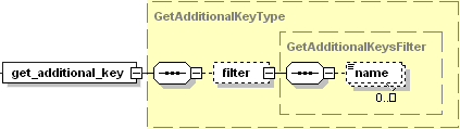

The get_additional_key node is presented by complex type GetAdditionalKeyType (server_input.xsd) and structured as follows:
image 36990
  • The filter node is optional. It wraps the filtering rules defining which additional keys data to retrieve. Data type: GetAdditionalKeysFilter (server_input.xsd).
  • The name node is optional. It specifies the additional key in format “[key_number]/[key_name]”. See the Request Samples section for examples. Data type: string.
To retrieve data of all additional keys installed on the server, use empty filter node, or omit it at all and send packet with empty get_additional_key node:
<packet>
    <server>
        <get_additional_key>
            <filter/>
        </get_additional_key>
    </server>
</packet>
or
<packet>
    <server>
        <get_additional_key/>
    </server>
</packet>

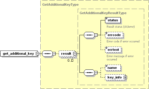

Response Packet Structure
The get_additional_key node of the response packet is structured as follows:
image 36992
  • The result node is required. It wraps the result of the get_additional_key operation. Data type: GetAdditionalKeyResultType (server_output.xsd).
  • The status node is required. It returns the execution status of the get_additional_key operation. Data type: string (common.xsd). Allowed values: ok | error.
  • The errcode node is optional. It returns the error code when the get_additional_key operation fails. Data type: unsignedInt.
  • The errtext node is optional. It returns the error message if the get_additional_key operation fails. Data type: string.
  • The name node is optional. It returns the value of the name node from request packet if retrieving the specified key info is impossible. Data type: string.
  • The key_info node is optional. It is required if the response successfully retrieves data of the specified key. Data type: additionalKeyType (server_output.xsd). The node structure is the following:
    image 36994
    • The number node is required. It returns the key number. Data type: string.
    • The name node is required. It returns the full key name in format “[key_number]/[key_name]”. Data type: string.
    • The active node is required. It specifies if the key is installed and working, or if it is expired. Data type: boolean.
    • The license_update_date node is required if key expiration date is defined. It returns the date (in format YYYYMMDD) when a grace period starts, during which the key must be updated. Data type: integer.
    • The lim_date node is optional. It returns the date (in format YYYYMMDD) when the key expires. Data type : integer.
    • The content node is required. It returns the key body. Data type: base64.
    • The property node is optional. It holds the collection of data describing a particular key property. Data type: AdditionalKeyPropertyType (server_output.xsd).
      • The name node is required. It returns . Data type: string.
    • The value node is required. It returns . Data type: string.
