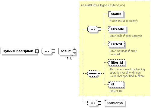

Response Packet Structure
The sync-subscription node of the output XML packet is structured as follows:
- The result node is required. It wraps the response retrieved
from the server. Data type: ResultFilterType
plesk_common.xsd). - The status node is required. It specifies the execution status of the operation. Data type: string. Allowed values: ok | error.
- The errcode node is optional. It is used to return the error code when the operation fails. Data type: unsignedInt.
- The errtext node is optional. Can be used to return the error message if the operation fails. Data type: string.
- The filter-id node is optional. It is required if the operation succeeds. Returns either subscription name, subscription ID, customer name, or customer ID depending on a way of descriptor’s specification in the request packet. For info on filters, refer to the Filters of Descriptors section. Data type: anySimple.
- The id node is optional. It is required if the operation succeeds. Returns the unique identifier of the subscription. Data type: integer.
- The problems node is optional. It outputs conflicts that occur on performing the operation. Data type: string.
