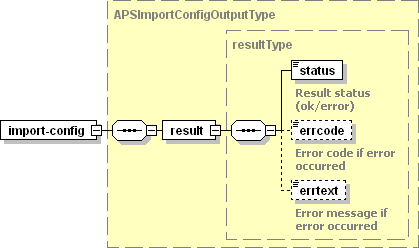

The node has the following graphical representation:
Response Packet Structure
The import-config node of the output XML packet is structured as follows:
result, required
Wraps the response retrieved from the server. Data type: resultType (
common.xsd). -
status, required
Specifies the execution status of the operation. Data type: string. Allowed values: ok | error.
errcode, required if the operation fails
Returns the error code. Data type: integer.
errtext, required if the operation fails
Returns the error message. Data type: string.
