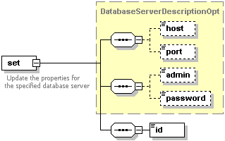

The set node is presented by type DatabaseServerDescriptionOpt (plesk_db.xsd) and has the following graphical representation:
image 37582
  • The host node is required. It specifies new IP address or name of the database server. Data type: string.
  • The port node is required. It specifies new port of the database server. Data type: string.
  • The admin node is required. It specifies the login name of administrator of the database server. Data type: integer.
  • The password node is optional. It specifies the password of the administrator of the database server. Data type: integer.
  • The id node is required. It specifies the database server ID. Data type: integer.
Remarks
You can change preferences for multiple database servers in a single packet. Add as many set operations as the number of database servers which preferences are to be changed.

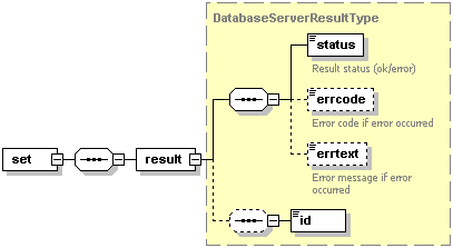

Response Packet Structure
The set node of the output XML packet is structured as follows:
image 37585
  • The result node is required. It wraps the response retrieved from the server. Data type: DatabaseServerResultType (database_output.xsd).
  • The status node is required. It specifies the execution status of the set operation. Data type: string. Allowed values: ok | error.
  • The errcode node is optional. Is returns the error code if the set operation fails. Data type: integer.
  • The errtext node is optional. It returns the error message if the set operation fails. Data type: string.
  • The id node is optional. If the set operation succeeds, it returns the ID of the database server. Data type: integer.
