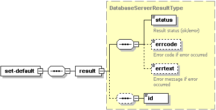

Response Packet Structure
The set-default node of the output XML packet is structured as follows:
image 37589
Note
  • The result node is required. It wraps the response retrieved from the server. Data type: DatabaseServerResultType (database_output.xsd).
  • The status node is required. It specifies the execution status of the set-default operation. Data type: string. Allowed values: ok | error.
  • The errcode node is optional. Is returns the error code if the set-default operation fails. Data type: integer.
  • The errtext node is optional. It returns the error message if the set-default operation fails. Data type: string.
  • The id node is optional. If the set-default operation succeeds and ID was specified in the request packet, it returns the ID of the database server. Data type: integer.
