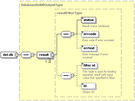

Response Packet Structure
The del-db node of the output XML packet is presented by type DatabaseDelDBOutputType (database_output.xsd) and structured as follows:
image 37559
  • The result node is required. It wraps the response retrieved from the server. Data type: resultType (common.xsd).
  • The status node is required. It specifies the execution status of the del-db operation. Data type: string. Allowed values: ok | error.
  • The errcode node is optional. Is returns the error code if the del-db operation fails. Data type: integer.
  • The errtext node is optional. It returns the error message if the del-db operation fails. Data type: string.
  • The filter-id node is optional. It returns the filtering rule parameter. For more information, refer to the Available Filters section.
  • The id node is optional. If the add-db operation succeeds it returns the ID of the database.
