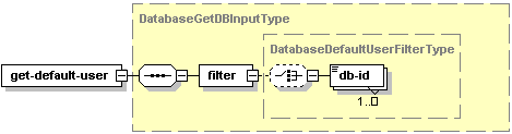

The get-default-user node is presented by type DatabaseGetDBInputType (database_input.xsd), and its graphical representation is as follows:
image 37563
  • The filter node is required. Specifies the filtering rule. For more information, refer to the Available Filters section. Data type: DatabaseDefaultUserFilterType.
  • The db-id node is optional. It specifies ID of a database. Data type: integer.

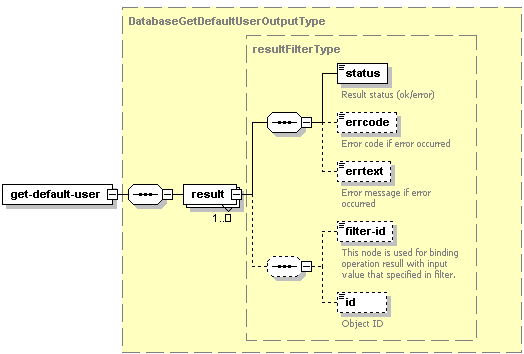

The get-default-user node of the output XML packet is presented by type DatabaseGetDefaultUserOutputType (database_output.xsd) and structured as follows:
image 37564
  • The result node is required. It wraps the response retrieved from the server. Data type: resultType (common.xsd).
  • The status node is required. It specifies the execution status of the get-default-user operation. Data type: string. Allowed values: ok | error.
  • The errcode node is optional. Is returns the error code if the get-default-user operation fails. Data type: integer.
  • The errtext node is optional. It returns the error message if the get-default-user operation fails. Data type: string.
  • The filter-id node is optional. It returns the filtering rule parameter. For more information, refer to the Available Filters section.
  • The id node is required. It specifies the ID of the default database user. Data type: integer.
