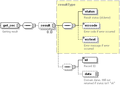

Response Packet Structure
The get_rec node of the output XML packet is structured as follows:
The result node is optional. It is required if the operation get_rec succeeds, and the data set retrieved from the server is not empty. Data type: resultType (
common.xsd
The status node is required. It specifies the execution status of the get_rec operation. Data type: string. Allowed values: ok | error.
The errcode node is optional. It is used to return the error code when the get_rec operation fails. Data type: unsignedInt.
The errtext node is optional. It is used to return the error message if the get_rec operation fails. Data type: string.
The id node is required if the get_rec operation has succeeded. Returns the unique identifier of the DNS record. Data type: integer.
The data node is optional. It is required if the get_rec operation has succeeded. Data type: dnsRecord (
dns_input.xsd
). The node is structured as follows:- The site-id node is optional. If specified, the DNS record is retrieved from zone parameters for the site with the corresponding ID. Data type: integer.
- The site-alias-id node is optional. If specified, the DNS record is retrieved from zone parameters for the site alias with the corresponding ID. Data type: integer.
- The type node is optional. It is required if the operation succeeded. It specifies the type of the DNS record. For more information about DNS types, please visit the Adding a DNS Record section. Data type: string. Allowed values: A | NS | CNAME | MX | PTR | TXT | SOA | AXFR | SRV | AAAA | DS.
- The host node is optional. It is required if the operation succeeded. It specifies the IP address or name of a host, that will be used by DNS. Data type: string.
- The value node is optional. It is required if the operation succeeded. It specifies the value that will be linked with the host value. Data type: string.
- The opt node is optional. It holds optional information about the DNS record. Data type: string.
